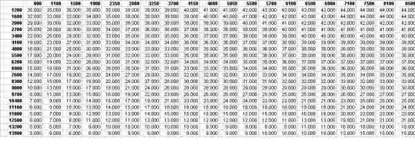

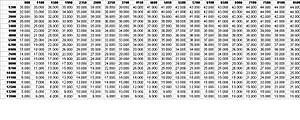

base Map/ Ing Map
here is my base map and Ign Map...
I will attach the Targeted A/F on the next Message
Attached Thumbnails Knock in High Boost with Right AFR-basemap.jpg   Knock in High Boost with Right AFR-ignmap.jpg

Pm me your DAT file and any recent log files that you might have, this way I can open them with the datalogit.* The ignition and fuel files will mean more if I can check the rest of your settings.* So said that you are using the innovate, are you logging the AFR's throught the datalogit? this is also very useful when tuning.* The log files will also shown me knock in the 4 ways, basic max, basic average, advanced max and advanced average.* You need to figure out if it is real knock or not.

from the pictures the timing looks at little high, have you looked at the actual timing versus the commanded timing? this can vary for serveral reasons one of which is battery voltage. Send me the logs and I can help

OK I will try to zip the log file first. as someone told me that the log file needed to be zipped if not the file will not work.. so I will try to zipped it, if u can't open it let me know. O and about the actual timing i think is at 10Degree..so my timing is a bit high..ic I thought my timing are too long...^_^ my mistake than...Haha..
