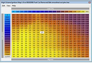

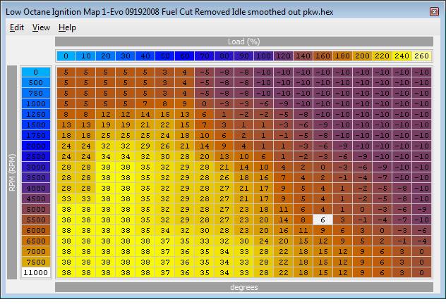

Thanks for responding so quickly I wouldn't be driving it if it wasn't my everyday car... I should also mention that I just replaced my front differential as well if that could possibly have anything to do with it.... I have attached my fuel and ignition maps high and low octane.
