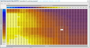

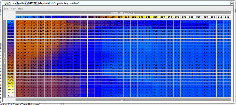

I am converting my rom to the terphra mod. I have transfered my maps to the new larger tables. I am just looking for a safe map to get the car back on the road to start tuning again. I have change a few things this winter. Just looking if anyone can see somthing that I have missed. I am planing to run about 22 to 24 psi.
Attached Thumbnails timing and fuel maps-fuel-map.png   timing and fuel maps-ignition-map.png
