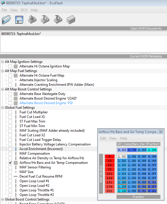

Try something like this - it works for me. Remember that you will have to tune the bottom row this table to suit your own needs, then blend it up for 2 rows. I originally tuned at 20C (MAF temp) and 100 kPa (Baro) which is why column 2 is all 1s. I tuned column 1 for winter down to -5C, then 3 for summer up to 40C.
