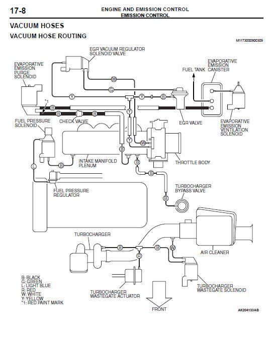

Anyone happen to know where exactly this hose connects? I noticed it tonight while putting my injectors back in.
this is a pretty bad picture but it's about as good as i could get. pic is taken from the farthest (to the right) gap in between the intake mani runners

Ive had a vacuum hose disconnect a couple of times. It connected to a nipple on the underside of the TB. I used a tie wrap to secure so it doesnt blow off
Heres the schematic view. May help you
