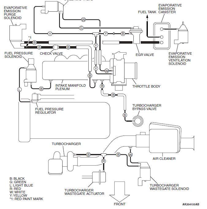

done a evo engine swap, just finishing lf and topping it with fluid tomorrow, need blind plugs for the oil cooler as the new engine is evo 7 and i could not get it to fit in my evo 4 chassie, and dont want to use the old cooler after old engine broke.
but i need som help on some small air connections.
the in is air outlet on the turbo, small plug, which cabel to attach here?
next is under the inlet, between air filter and turbo.
the third is on the wastegate solenoid.
please look at the lictures, got a 3 way split that is showing on 1 picture, where 1 end goes to the wastegate solenoid, and the other to the wastegate, guessing one of them above is taking the last spot.
hoping someone can help me so i can get the engine running tomorrow
Under inlet
Outlet turbo and 3 way split
Wastegate solenoid

These 2 diagrams are for the EvO9 engine but may be similar to the 7
Just trying to help

Perfect!! Thanks alot
