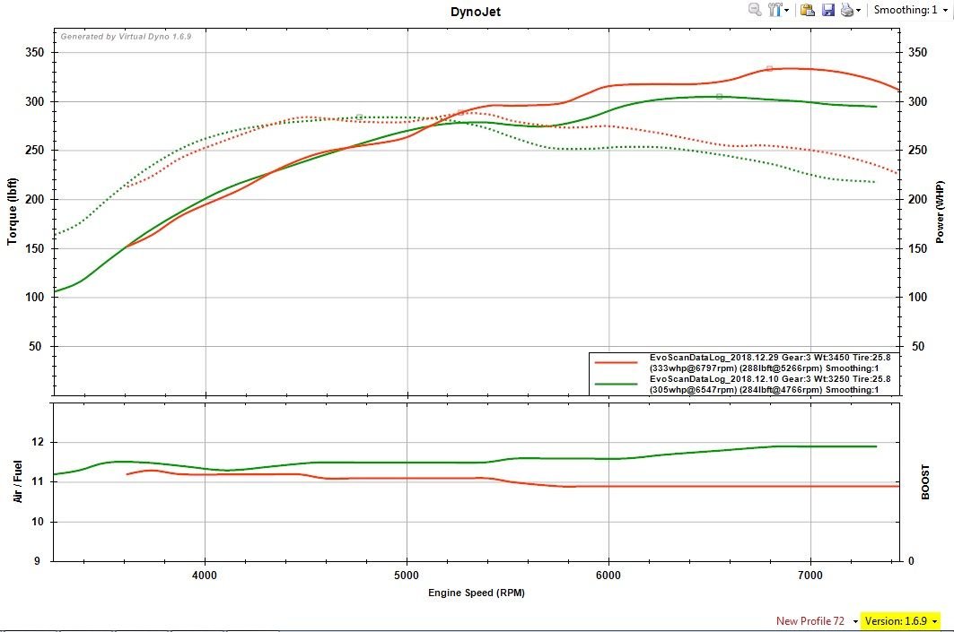

Stock motor with stock turbo I was Making 290 to 300 Hp @ VD, Boost was 1.7 bar tapering to 1.5 . I also have a Dyno Graph for that..
When I installed the cams the car started to knock with the Previous tune,boost was 1.4 bar at this point. took out some timing and it still knocked took more timing out ..
it keep knocking untill I reduce the Boost to 1.3 bar(lowest I can go) .

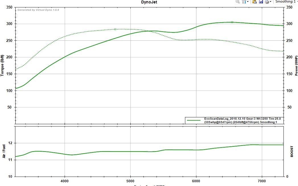

Finally where it stopped Knocking I put the details in the VD and found its now making 284WHP. :/
Compression Graph Stock Cams Vs S2 with Billet wheels

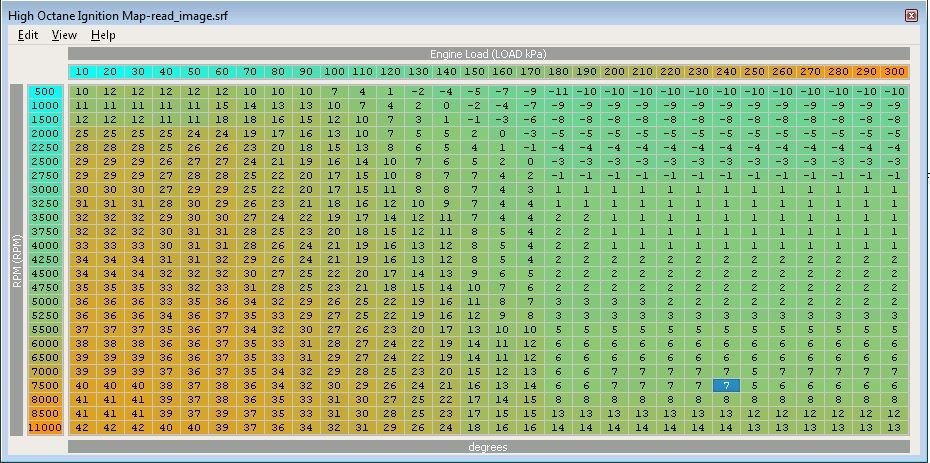

The Timing at which It stopped Knocking..at this point adding a single degree would make it start knocking..
at some rpm point it have 2 counts of knock still...
Asked a friend to Send me his map.. that was an Evo 8 ,
flashed it and took a run and it ran perfect and the results where recorded on the graph.
Stock Cams vs GSC S2 and Billet wheel.
Was very happy to see the result , but it didnt lasted long ...
The Second time I Floored it, it knocked way badly as the timing was way aggressive in my friends EVO 8 map..

1- Ignition map- It is way too conservative

His timing map might be conservative because he's using 92(ron) fuel. But you need to verify if your knock counts are real via the use of detcans, those head springs & retainers can cause phantom knock. I believe that the S2 cams are mismatch with your turbo, you'd need a much larger turbo to take advantage of S2s gains which are beyond 6000rpm. I'd install BC stage2 or HKS 272 or Tomei poncams with such sized turbo.
