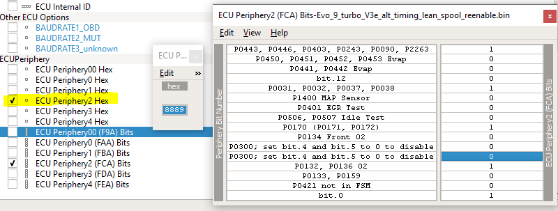

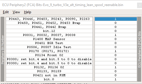

I'm not an expert in ROM disassembly, but it looks like the the FCA periphery bits are defined correctly for the 9626 ROM... but I could be wrong.
Did you edit the bits using the correct method? In the image attached, to enable the two P0300 tests I would edit the highlighted table and change the value from 0x8889 to 0x88B9. I know you want the tests disabled, so this is just an example.

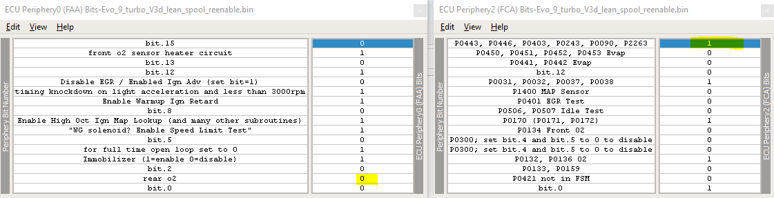

Have you followed the steps in the thread that I linked to above? There are a bunch of screenshots that help clarify it.
I compared the screenshots of the periphery bits to mine (in 9626) and there are a couple of differences, I think. I have rear O2 disabled and still have bit 15 in FCA enabled:
