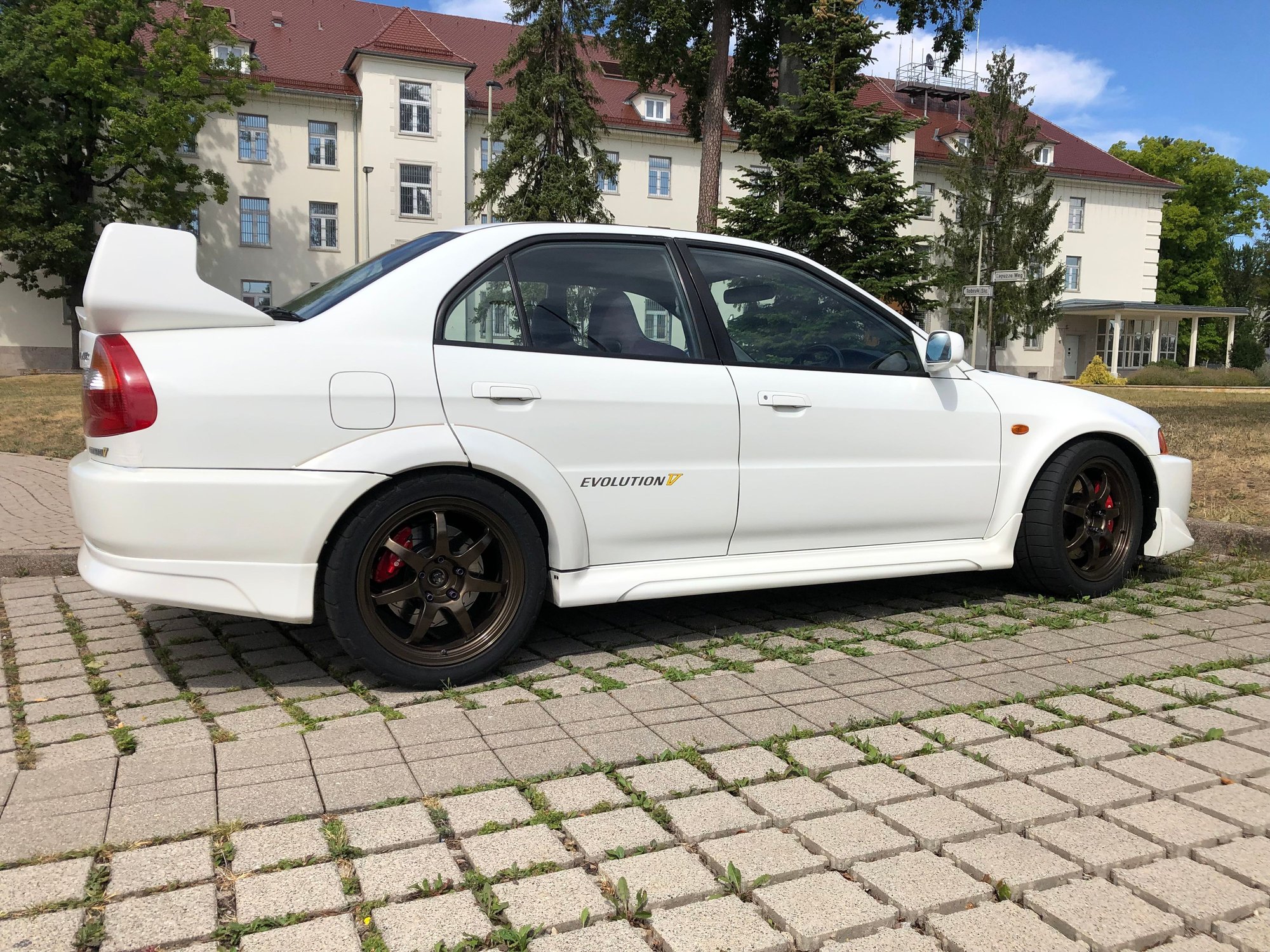

We have an Evo 5 here in Germany and with a fresh OEM plus engine (forged internals, GSC 1 Cams/springs, ATP intake, 1050 ID injectors, Evo 9 turbo, full 3 inch exhaust with 200 cell cat).
Currently OEM ECU with no boost...runs great with 25 mpg!
But we have just received a full Link Evo 8 ECU (CAN Wideband and harnesses).
Does anyone have a similar program to start from?
Thanks!

tunermt: Thanks for the follow up...looks like I never replied originally - apologies.
I did get it running. Even Link provided a base tune for the 4G63 and it ran quite reasonable on it (no WOT). I then contracted Jay @ Boosted Tuning who has been very helpful especially around the messy weather Stuttgart - having to take a winter break. We are reconvening though and hope to have WOT complete in near future.
