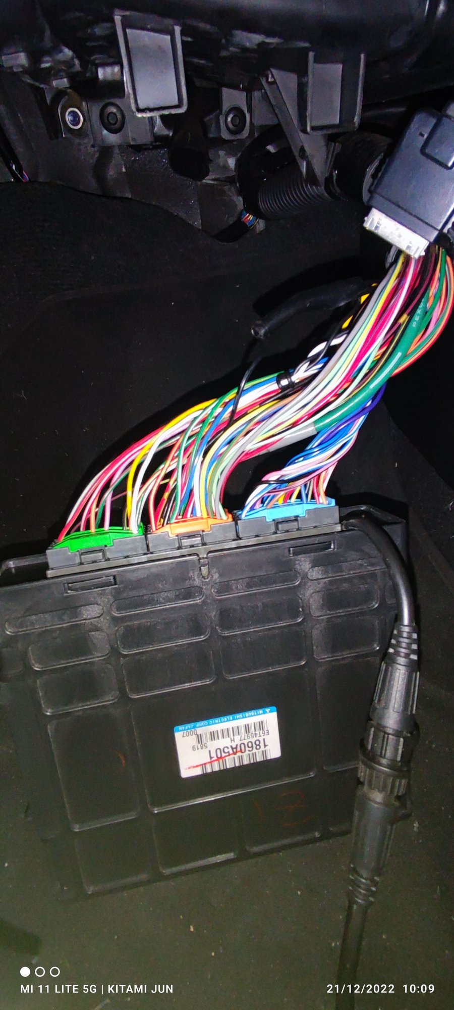

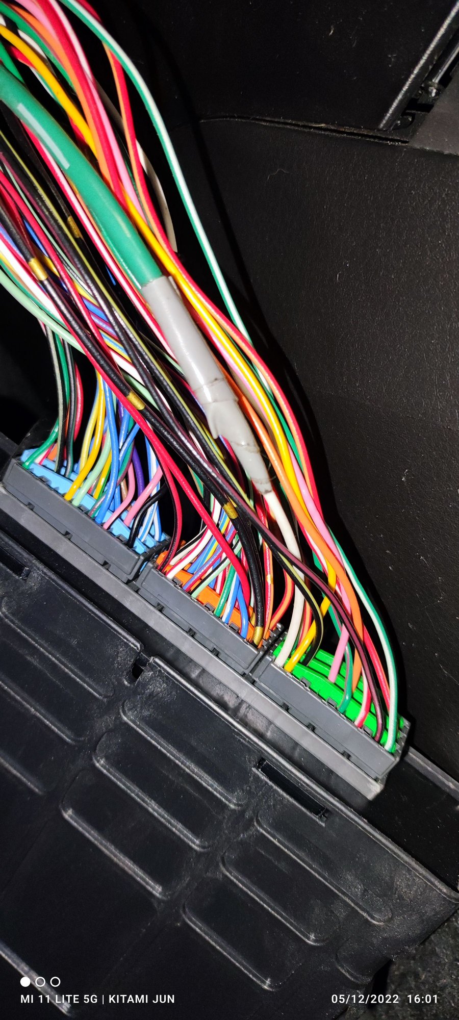

Hello guy's,
I have sent in 2014 the ECU to NR Autosport (UK) to remove the password and get the cable to link ecu to computer and turn me back the same year.
I was stopped to run with my Evo in this same year.

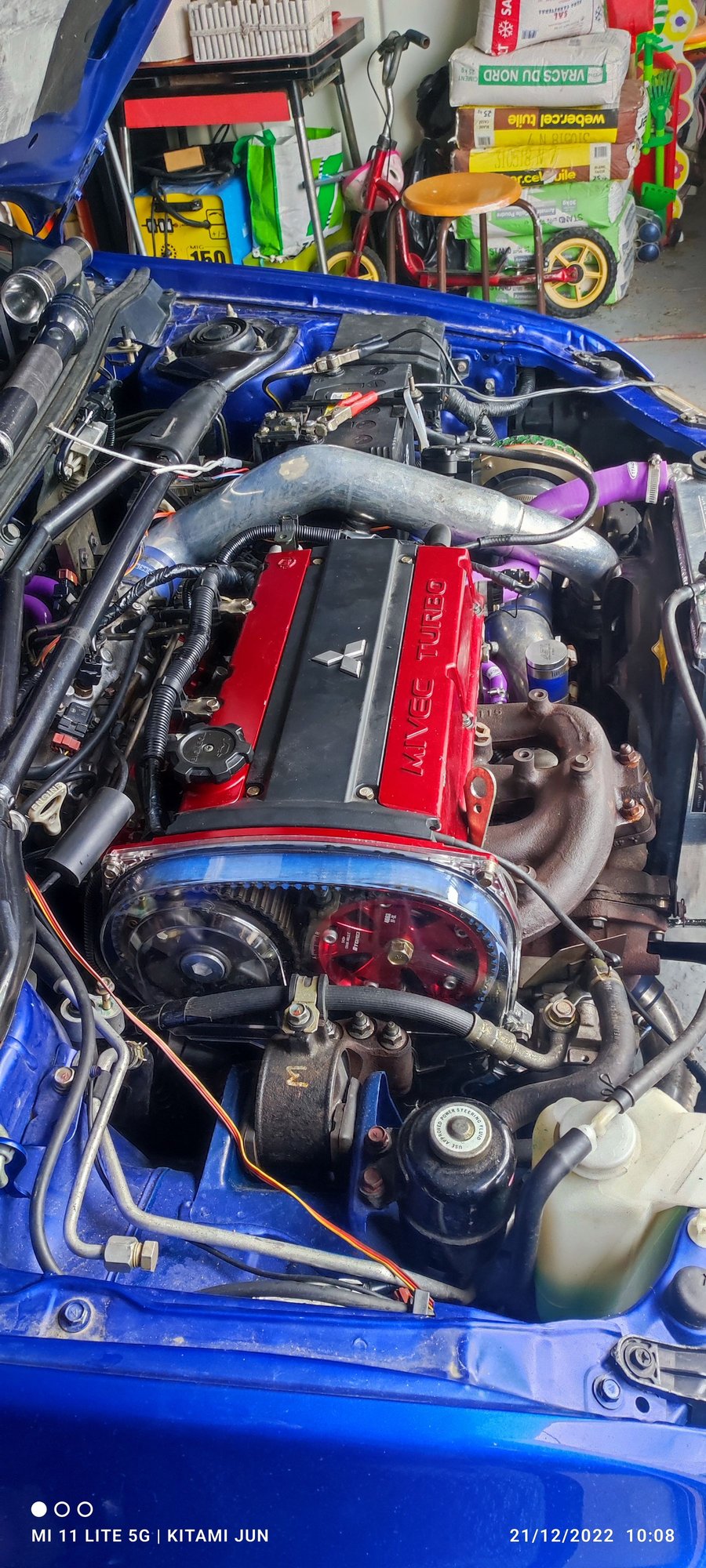

After a few years i decide to refurbish the engine with some parts added.
The car don't have MAF when i buy it.
Parts Add:
AEM Fuel Pump
AMS Fuel Rail
RC Injectors PL9-1200
TOMEI Exhaust Cam GearJUN Cams
H-Beam Manley Rod
Pistons MAHLE 86 Bore
Stock E9 Turbo
Featuring:
AMS Exhaust Manifold
I have 2 New Turbo (GT3076R & PT 6262)
External PT Waste Gate.
At the moment the car doesn't start.
Few weeks i try to start them.
I think they have something wrong,
I'm newbie in that,

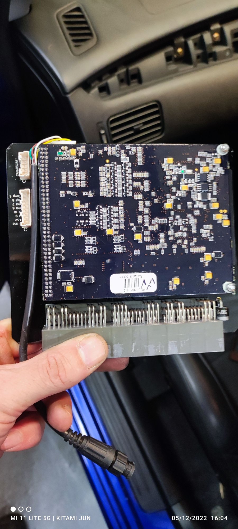

But i put the base Map onto the VI-PEC ECU (E9 PCL)
with the procedure,because NR have erased the map.
This an ECU V-Series PnP working with VTS (see Pics)
I try to start but nothing...
Needing really help.
