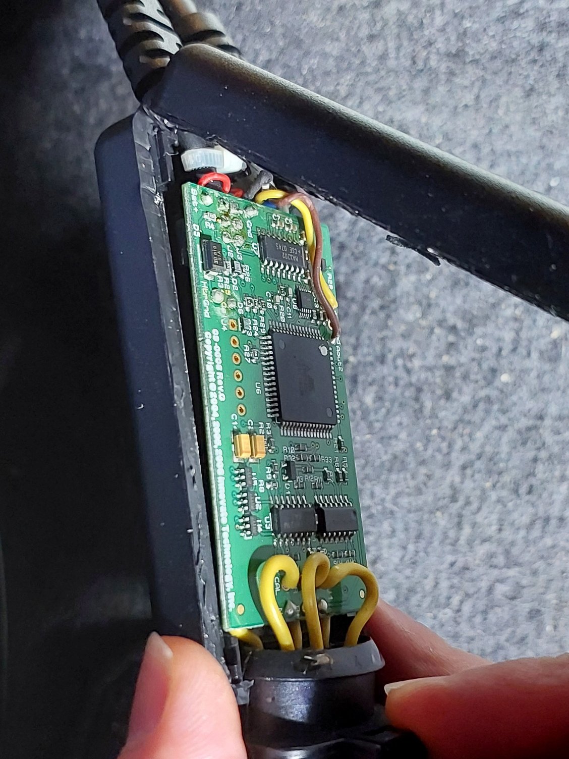

FWIW here's some pics of the LC-1's guts:
