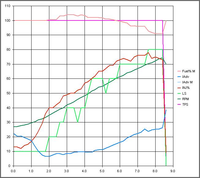

BTW, how much timing were you running? On my car its actually pretty aggressive ECU timing at higher RPM, it didn't need much timing played with.. I started noticing in the midrange was where my car could start using a bit more aggressive timing.

i just looked at what the ecu was running on your map and then pulled it back 1 point and then 2 points from 4250 to 7500 across the board.
this graph was your map with stock timing on my car. so you can look at that and see what the adjustments were for the last 2 runs. run 1 was stock ecu timing, run 2 1 point, run 3 2 points, run 4 2 points boost increased 1 psi.
i am done racing or tuning until i get my new clutch, WB, and guages installed. just wanted to play a little.
