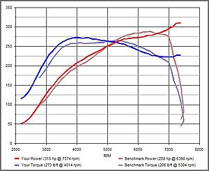

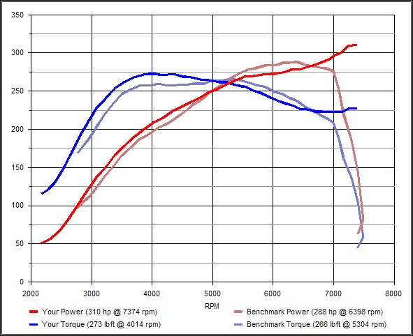

ok.. here's a few things I observed from your pull.. the last few samples of data are missing that shows the "downturn" of the engine.. so it shows a trend that is still rising.. you need one or two samples of the end of the pull otherwise the program thinks the HP is still climbing at the last sample.. (It very well could be)
Also, weather and altitude have an affect on power output, that is why corrections are so important.. however you can see in the graph (the pull that says "your power" is yours, and the pull that says benchmark is the last pull that was supplied by archie.. The curves are very similar, though the peaks are slightly different.. However if you applied correction to it, I'd suspect they'd be much closer.
This graph, both pulls, no correction, smoothing at 3..

Ok.. now, I can tell from your pull that your boost level is different, you appear to be getting a spike of boost earlier, tapering to around 19 or so PSI.. notice that archie's torque curve is flatter, which means that his boost climbs to 19 or 20psi, but remains there until later in the RPM range where it drops slightly, but not by much.

What is interesting about your car is looking at the data, the stock ignition timing is wacky.. its trying to retard timing after TDC as you approach torque peak.. That is a classic symptom of an aftermarket intake (hence why people feel like they've lost power) Your timing map is similar to mine however and a bit more aggressive (7 degrees) compared to archies (around 4-5 degrees) Fuel quality makes a big difference in this case..
Since you guys don't have EGT or AFR I wouldn't recommend trying to make any more changes until you can get on a dyno..
But (Hot Feces) in your case, the HP numbers are off because the last sample shows HP climbing so it trends higher instead of finding an actual peak.
