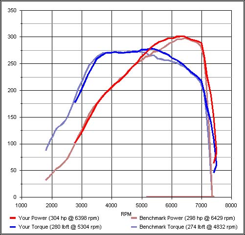

See the overlayed plots... Good Illustration of your gains across the board, however I think some of this is weather differences since I don't know what the conditions were to apply SAE correction..
The numbers are off, but the delta gains would be accurate if your running conditions were similar..

That is a huge jump in power.
The first run was when its about 90 degrees F
The second run was when its about 74 degrees F
I don't know if the power I've got is from the settings or the temperature change?
What do you think?
Thanks

A little of both.. 20 degree change in temp isn't going to account for the entire improvement, but about 80% of it..

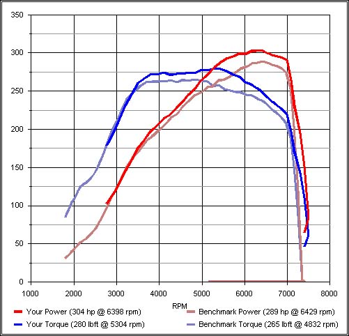

Ok.. with the corrections you can see the changes made a little bit of difference, but not drastically..
This is a good illustration of how conditions can affect power output...

I think this also proves that "data log lab" with SAE corrections is a useful and consistent tuning tool assuming these things:
1) Record Temp, Humidity, and find out the altitude in your area
2) Always make your runs on the same stretch of road, and in the same gear (3rd)
3) Make sure your calibration file accurately reflects the tire size, and driveline losses
These were two different runs at two temps, and two different days.. yet their surprisingly similar in the areas that weren't modified.. it proves that this can be a useful tuning tool, just don't expect your HP numbers to be all that accurate, what is important is the difference between two runs can show improvement and therefore you can tune with it.
The more comparisons to dyno #'s I can make, the more I can calculate the losses and provide more accurate calibration files to the guys at Data Log Lab..
