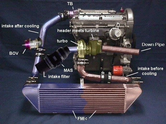

ok.. now i'm totally 100% lost. on an intercooled kit, where does the ic pipes connect? where does the turbo connect? how can i use an up-pipe and down-pipe instead of an exhaust manifold? can I still put a header on my car if i do this?

damn homie. thinking whether i should just hand you a book or just tell you to search. this came from this thread https://www.evolutionm.net/forums/sh...t=turbo+layout

ok. so the fmic does absolutely no intake right?

the front mount isnt the intake? you have a separate pipe that comes off the turbo with a filter on it used for intake is that right?

yup.
