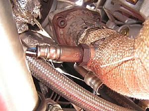

Here are the pics of my TSI kit on my car!!
Pic 1 and 2 are a overall of the engine bay.
Pic 3 is the downpipe that needed to be modified. That whole thing with sticking a couple of extra gaskets on it to space it down doesnt really work well. It'll still hit the oil pan and puts the exhaust out of line. My solution to the problem was to add about three inches right under the flange by add piping and welding it. Also, a O2 bung had to also be welded in. The one in the pitcure is the one i added. Its missing when you get the kit. Use a nut or spark plug failure (same thing they use to trick the rear O2). They're simple mods you can do or your local exhaust shop can do.
Im open to questions about the kit.

I see you didn't have to get rid of the 2nd fan... is this due to it being a non-ic'd kit?
Also that heat sheild you have made on there... doesn't the kit come with a sheild that looks nice to go over the entire manifold?
Did you have to extend your O2 sensor wire to get it to reach?
Have you had any melting issues since you kept both fans in?
Lastly do you have a vented hood to help get rid of the extra heat or all you all stock/sleeper looking? Asking this as there have been a lot of melting stuff issues with that kit. If you have a vented hood that could be the reason your not melting and kindof a must have then.
Looks like the install was pretty clean and done well... what did you do for supporting fuel mods?
Can you show closer pics of turbo/exhaust manifold/wastegate/etc... just want to see if it is all the same as the others i've seen in person. So far you're the first non-ic'd i've seen/heard of.

The kit does come with a shield but it does not go down far enough to protect the fan. The fan did start to melt, so i made that shield to protect the fan and wrapped the turbo. No more melting. As for extra heat in the engine, there really isnt to much more heat b/c the TSI kit positions the turbo down instead of up like the RRM and i also ceramic coated the manifold and pipe to connect to the downpipe from the turbo. The ceramic we use at our shop does hell of wonders. It keeps the heat from escaping into the engine bay. Spend the extra money and use ceramic coat. Its one of the best ways to keep heat down. I really didn't want to spend the extra money for a fan if i didnt need too.
As for fuel mods, I threw out the TSI FMU and bought a 12:1 Vortech FMU and Walbro 255 pump and stay with the stock injector. With 7psi i/c at full throttle the EGT wont go over 1450*F.
I didnt have to extend the O2 sensor wires at all. Its called good planning.lol I put the O2 sensor almost in the same place as it was before. In the rear you just use two of those spark plug things and no CEL. This kit eliminates both cats.
The TSI kit i bought was the base kit for the lancer. No intercooler or fuel stuff was included. I bought an intercooler and universal intercooler piping kit to make the intercooler sytem. The other more expensive TSI is garbage i think!! Im not really fond of extra injectors in the intake.

I ditched the TSI FMU b/c i really didnt trust it and i wanted to run a 12:1 ratio. The TSI FMU i think was a 10:1 and the EGT's were rising to high to fast. A ball park figure is about $2500.00. The kit runs around $1600.00 and you need small stuff like a BOV, fuel pump, boost controller,gauges, turbo timer, extra steel lines, intercooler and piping ( if wanted). Then there is also the downpipe welding and ceramic which shouldn't be more than $150 to $200 altogether.
The wastegate on the turbo is a single port internal one. Very easy to control boost.
