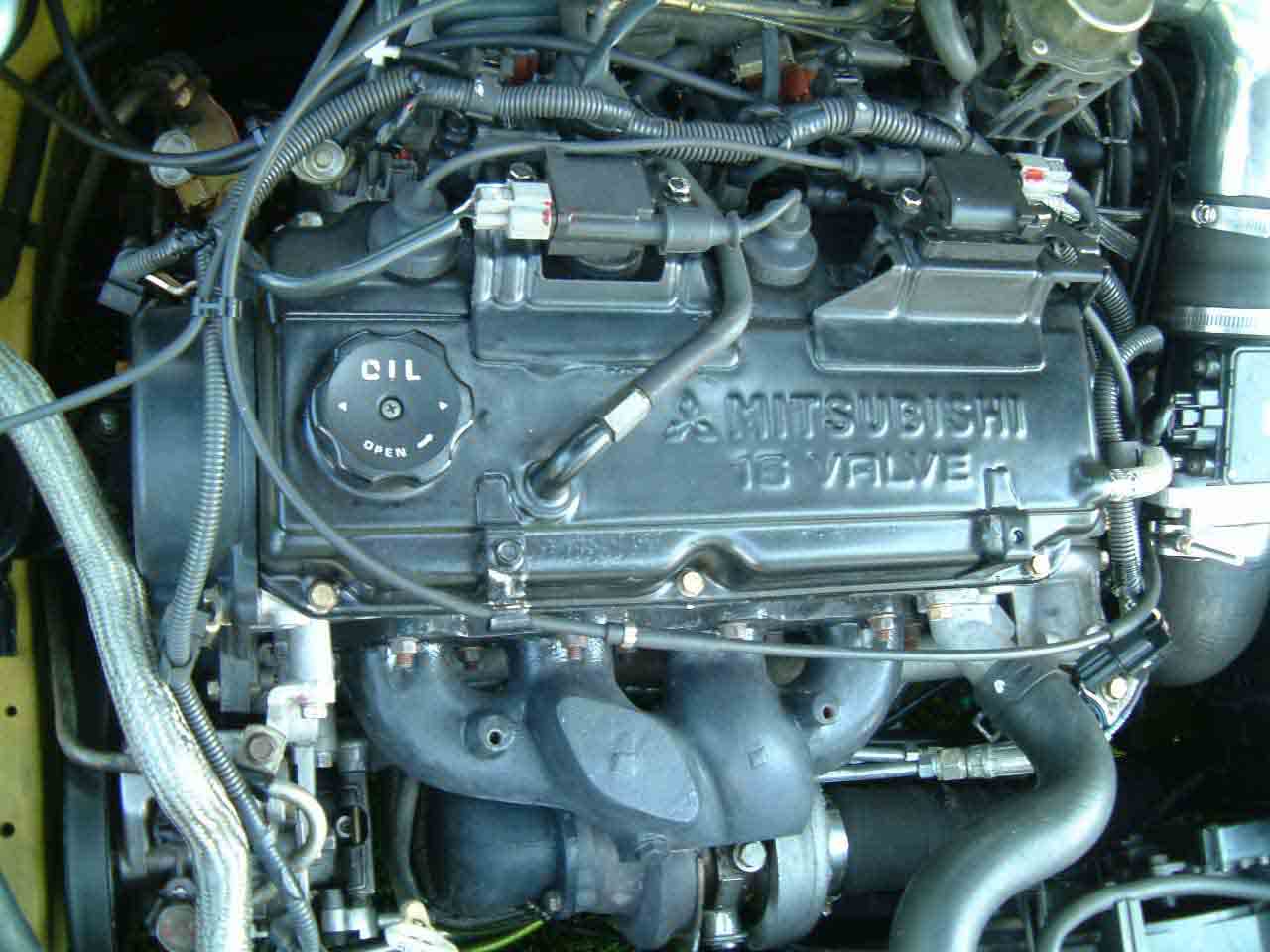

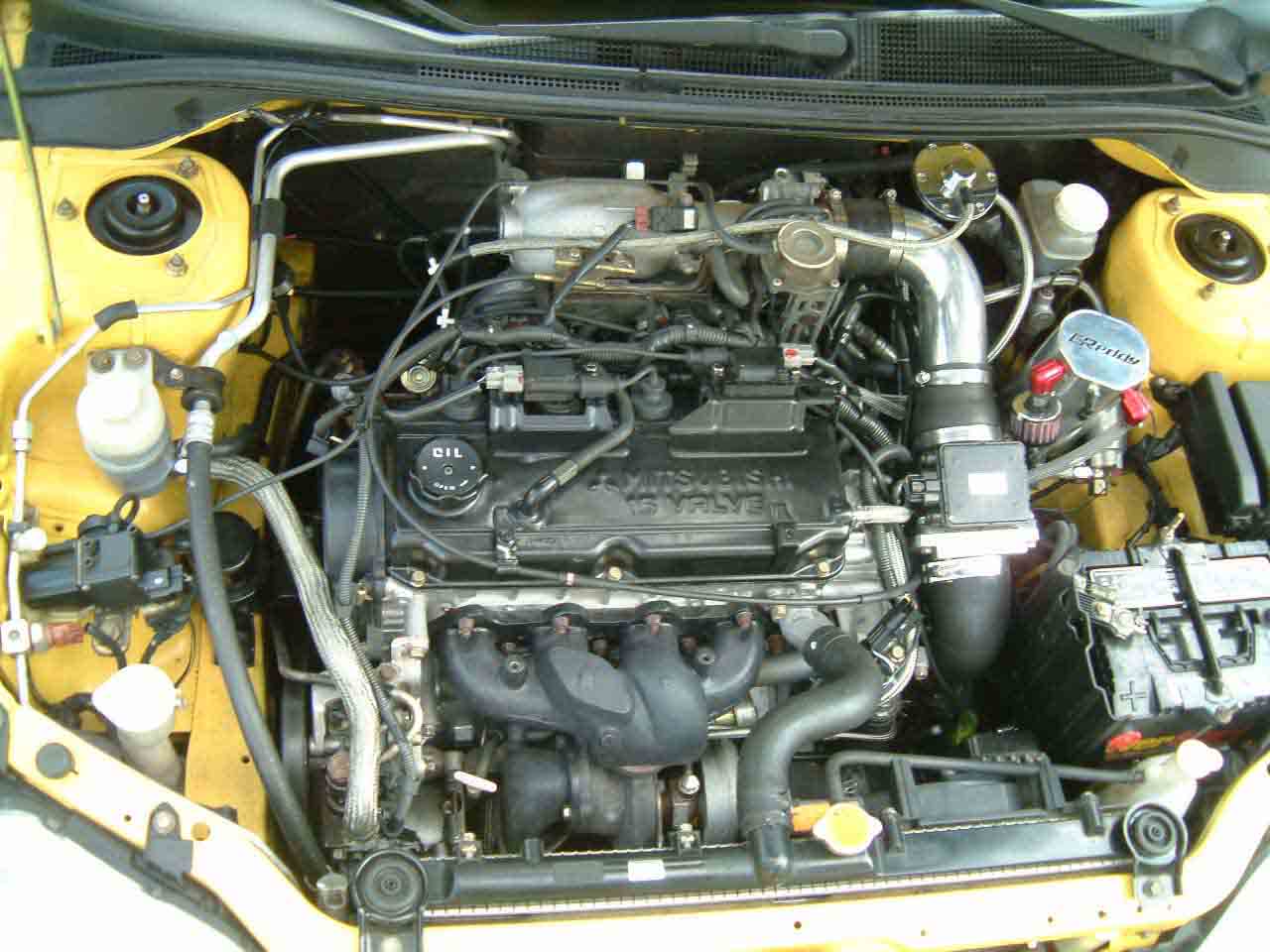

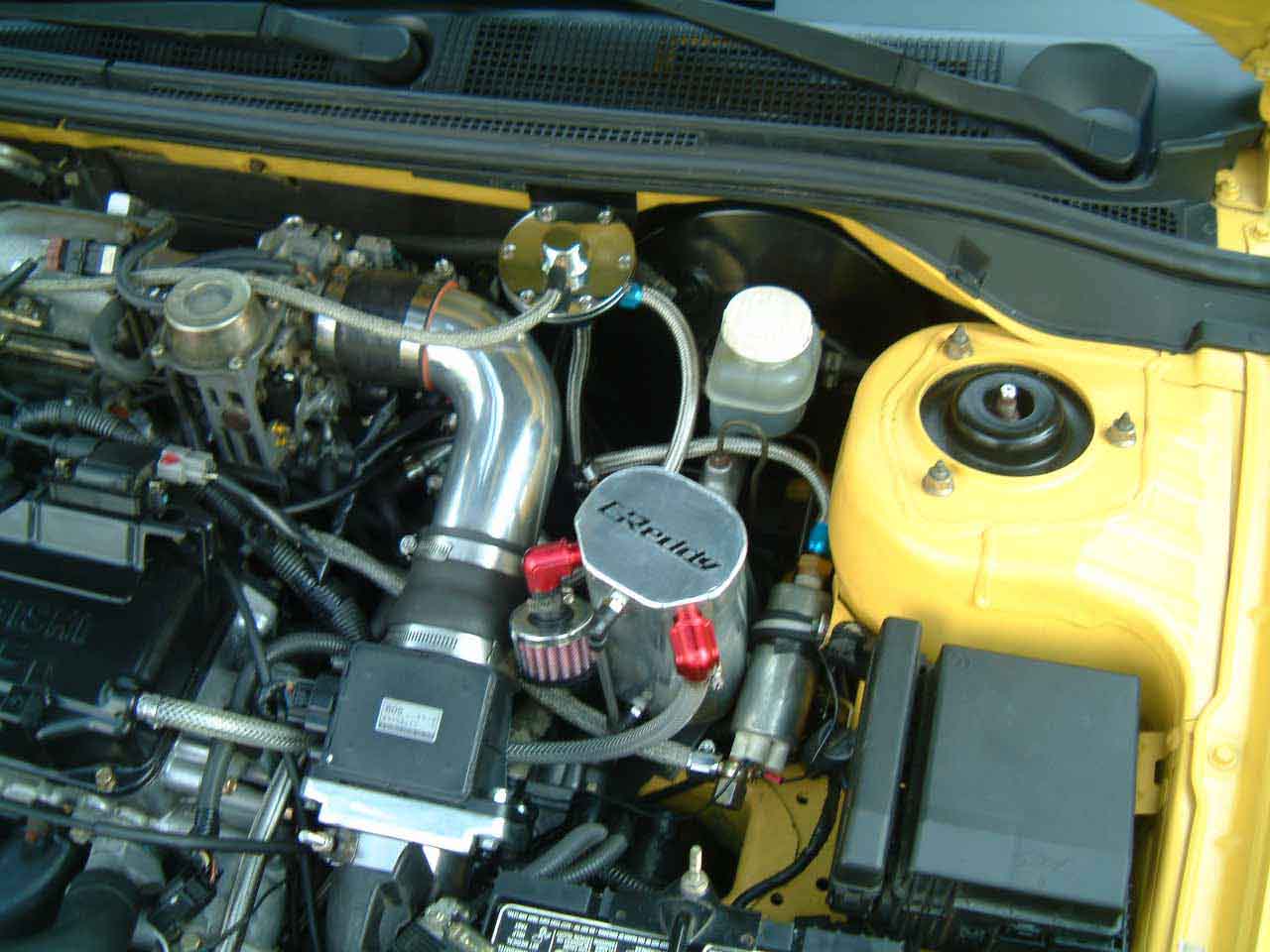

Alright lets keep this thread civil guys, the point of this thread is for the install pics of the tsi kit with a few mods and dress up mods, in no way is this a thread meant to discuss whos d**k is bigger than whos or better, I will be honest and un biased about the pros and cons about this kit, this is to help every one out especially the tsi guys who are having difficulties. Let the ?s begin.
Attached Thumbnails tsi setup pros and cons-catch-can.jpg   tsi setup pros and cons-engine-close.jpg   tsi setup pros and cons-engine-far.jpg   tsi setup pros and cons-turbo-manifold.jpg   tsi setup pros and cons-intercooler.jpg

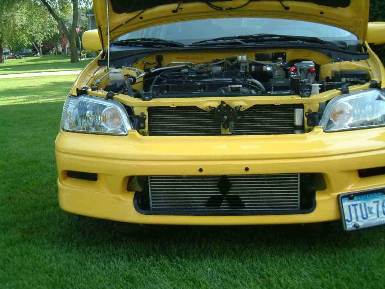

Few more pics for yall.Including my homemade intercooler sprayers and the shaved trunk.
Attached Thumbnails tsi setup pros and cons-front-end.jpg   tsi setup pros and cons-front-side.jpg   tsi setup pros and cons-rear-side.jpg   tsi setup pros and cons-water-spray.jpg   tsi setup pros and cons-trunk.jpg

had to figure out that the mas had to be in the same place as it would be for a cai, buy 2 more gaskets to extend the pipe past the oil pan shave the pan for a few minutes and mount the blow off valve before the mas.Cut the bumper for the large intercooler. And get something else for a fuel pump either an inline like me or a stock upgrade. But the fmu is nice 14:1 and a loud *** blowoff valve.

As far as I can tell the only problems I have with the kit are the manifold design...which isn't the worst design, but certainly not the best imo, the placement of the O2 sensor (again, could be worse, but of the kits available it's the worst placement imo again), and the fuel management. I just don't true the simple high fuel pressure approach to fuel tuning. It lacks...well...tuning. Otherwise, I think it seems like a very nice alternative to more expensive RRM and RPW kits, though I don't see it as being the kit with the most to offer.

People on the MSP forum are concerned with putting the MAS after the turbo. They say it could cause premature failure of the MAS because of the added air pressure (the MSP has stock BOV issues, so people move the MAS and then vent to atmosphere). Do you feel there will be any issues? Why do it that way instead of mounting the mas pre-turbo?

From the TSI kits i've seen the T-25 isn't an exact fit for a true garret T-25/28. The exhaust housing on the TSI kit was a round 3 or 4 bolt flange. The Garret T-25/28's are not flanged in this way.
Any insight on this Ryan or another TSI kit owner?
Do your turbo's have the round flanges? The 4 that i've seen all did and the turbo's were knockoff garrets. That's one of my biggest gripes with the kit as their are known issues with the knockoff turbo's over time.
Also do your O2 sesor pipes drop down the left side of the turbo in kindof a flattened L shape? The one's i've seen have and that seems very restrictive to me. It also makes the O2 extension a must.

Its round but its got the garrett words casted in it and it has a serial number tag from garrett , this isnt a normal garrett turbo it spools different and it boosts higher i ran all weekend pissin off v8s at 12 psi fri and sat with no sweat, with this set up im sure the kit isnt putting up huge horse #s but with it , its putting out some hellla torque. When i let one of the guys with the road race kit boosting at 7-8 psi drive my car he was amazed at the torque and the acceleration 0- 100. I will admit its not as fast 90- on but im ok with it because i dont feel like going that fast on the highway and getting caught. I love getting smashed in the seat through 3rd gear.

I drilled a hole in that L pipe and welded a nut to the pipe for my o2 sensor, the 2nd sensor does have a hole pre made for it in the 2nd pipe they send you that eliminates the cat. The pipe does seem small i was going to make an exhaust cut out to come straight out behind the front wheel with a remote butterfly to open it and have it close it to run the current exhaust, to see a difference. Im just scared because i like the way the car spools and creates torque and i dont want to lose that torque to gain a couple extra horse.
