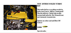

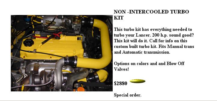

YEah im dealing with the same desision but im sticking with non intercooled because then i can get an evo ii spoiler and a strut bar with the money i save. This is the kit im getting. is it a good choice ? Well here is a pic of it off roadracemotorsports.com
Old Apr 28, 2003 | 09:26 PM
vegasboy301's Avatar
Joined: May 2002
Posts: 4,502
From: Los Angeles, CA
i actually sont know cuz i do have to wait if i want to get intercooled, but what will and intercharged kit do diffrent from that one ^?
