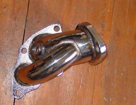

This is where the down pipe goes? i need an 02 housing dont i? what am i missing here? where can i get a flange to make a downpipe?

You can get either a O2 dump tube or whatever dp flange that would be and weld on a bung for the O2 down about 16".

o2 housing and downpipe

something like this?

Go to ::
Forced performance
deadboltenterprises
turbochargers .com
They should all have the o2 housings. What T-25 is that from, there are a few cars with T-25 like the mazda 5, Eclipse GSX and others.
That turbo looks like the internals seals are fried. My .2c

do you think it worth fixing?

Uhmm, I thought the Nissan 300Z comes with mitsubishi 13G... If I was you, I would ship it to Forceperformance and have them get you a proper o2 hosuing(that is what you are missing).
What is your project? please lets us suggest on this matter, we have many people on this forum that have done many projects from scratch including myself.
That turbo looks like it has a internal oil leak, you can tell by the oil residual. It should tipically have either black "podwery" color or copper copper/rusty color, your looks like totally oily.
It depends, sometimes you can get them used and complete for less. What are you using it on?

I'm going to put it in my 02 lancer es (auto). I was going to go rrm turbo but havent been able to save up the money fast enough. I have an intercooler fron an evoVIII and since i just got this turbo for free figure i could piece one together,

yea that turbo has a bad oil leak inside. you need to get a turbo rebuild kit or just buy a 16g off of here that is in good shape (thats what i would do)

a busted turbo is not a good startign point imho.
fabing a manifold is a pain, then u have to buy a wastegate, fmu, injectors, fuel pump, slim fan, downpipe, ic piping. etc and you likely need to remove ur battery to put in the ic piping.

OK scraping the t-25 turbo idea. looking into used 16g. thanks all for the help.

I am just saying that its very time consuming and hard to put together a kit that works properly and looks descent.
