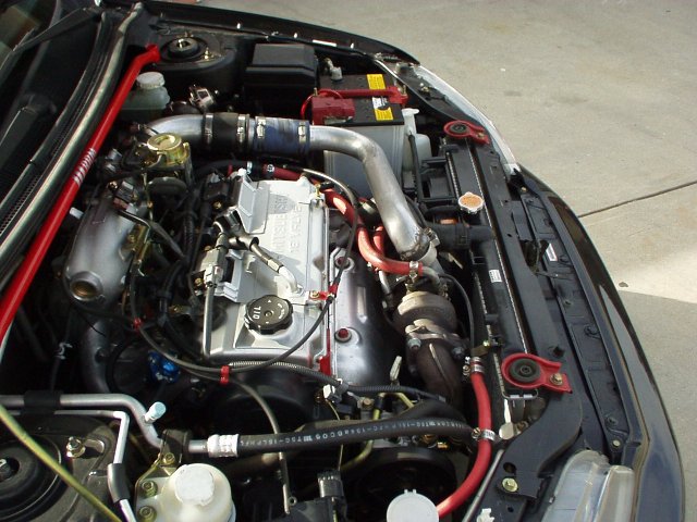

i personally would just mound it left and right, i think the turbo will peform better and there will be less wear and tear on it due to its mounting. just my $0.02
Link
PS. Custom jobs are cheaper and take longer but are soooo worth it, GOOD LUCK!!

Ok the thrust bearing write up is exactly what I needed to hear. Now I can show my dad why we cant put it straight up and down. I guess Im gong to start chopping up my kamikaze to fit as the turbo manifold, which is what I originally planned to do from the beginning. Thank for the help.
