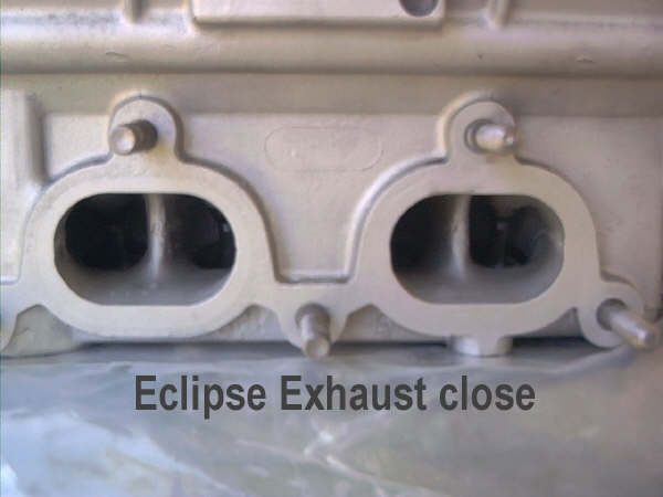

It ain't gonna fit...lemme find the pics of the exhaust ports on the block and I can show yas. It's a comparison between a 'G63 from an Eclipse and 'G93 from a Mirage.

Sorry, they're not hosted so I'm glad I saved 'em. Here's the Eclipse exhaust.

It should fit then. Guess you couldn't steal the turbo manifold off of a GS-T/X?
