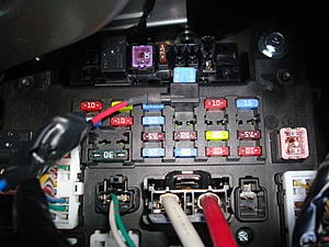

Then i connected my REM wire into the fuse box under the dash. I used a Add a fuse adapter (15$) and added it to the 30Amp radio fuse.

I routed the battery cable thought the existing car wires. So it goes through inside the car. To find your speaker wires just remove the panel between the two doors turn your stereo on and use a tester. your two speaker wires will be the only two wires that have current. (my two wires were different than the lancer here) And for the Amp REM I just used a add-fuse-link and just plug it in to a fuse. I dont hear a popping noise when i turn my car stereo on. Just make sure that you use a fuse that turns off when the ignition is off. In my car the cigarette lighter. Hope this helps
Attached Thumbnails Amplifier Installation + Remove Radio.-dsc02821.jpg   Amplifier Installation + Remove Radio.-dsc02822.jpg   Amplifier Installation + Remove Radio.-dsc02823.jpg   Amplifier Installation + Remove Radio.-dsc02832.jpg
