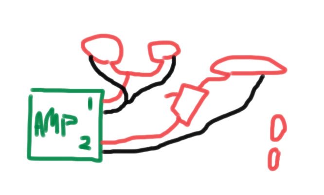

here's the diagram i had goin. it did work, until i crossed those wires. anyone that knows about wiring have a better idea for me or will this work fine. as you can see, channel 2 has quite a load, but it's never powering it all at once, it's either the 1 speaker, or the set of 2 speakers. anyone that can help, please do so, because i'm gonna tear out my wiring and start over.

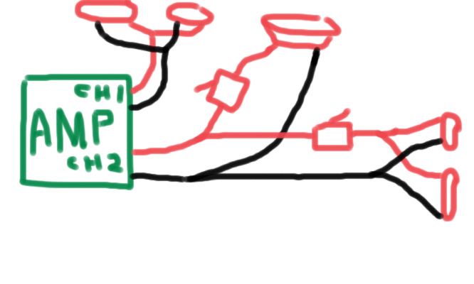

here's the new diagram that i have set up. seems to work just fine, but how can i include the other 2 speakers. any wiring experts out there know what to do. keep in mind that from channel 2 it will power either the single speaker or the pair, but never both at the same time.

dry erase board with a scanner?
that's different.
most people would ahve used paint.
could you ahve possible hit the power to the amp to your HU rca's? that would cause some funky things.
Old Aug 1, 2003 | 09:01 PM
SICKdimension's Avatar
Posts: 240
From: NA
no dry erase board, its photoshop. and thanks for the suggestion, but nope, definitely didnt do that
