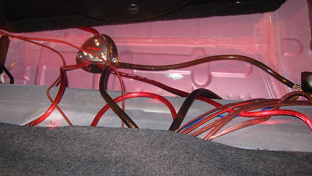

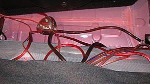

I will post up pictures soon, but my only concern is my mounting my power block in the base of the trunk. I used two self drilling taps, about 1in in length... whats the clearance between the top of the gas tank, and the bottom the trunk? I really hope I didn't hit the top of it

nah you should be fine man. my box is held in with L brackets and I used about 1" self tappers and its fine lol hurry up and post pics! oh and what amp did you wind up using? what other equipment did you wind up using?

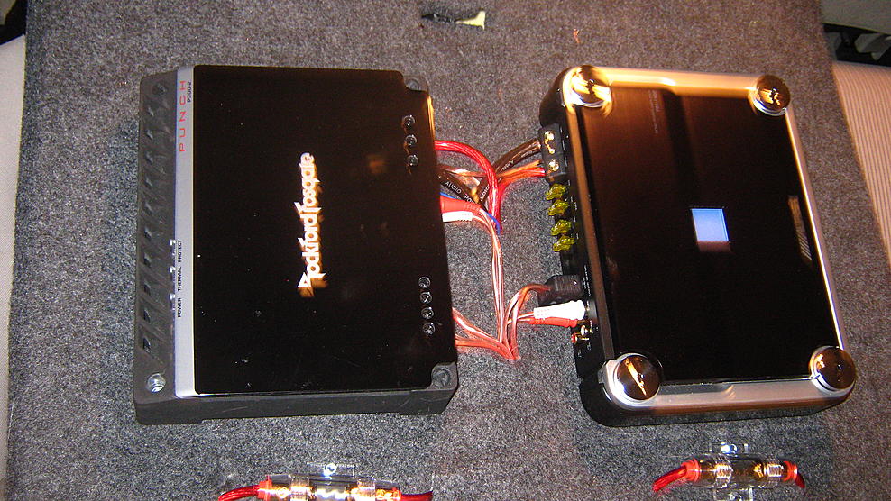

I have the alpine pdx 1.600 powering the 12w6v2-d4
a fosgate p300-1 powering my Infinity Perfect Series 6.1 and my infinity kappa 62.9i
ANL 150A fuse on the main 4gauge power wire
80A on the Alpine 8gauge power wire
60A on the fosgate 8gauge power wire
Line outs on the front and back channels behind the factory HU
And I installed a kill switch for the sub amp, and have it set in the dash in the little switch inserts to the left of the steering wheel... along with my starter kill switch for my remote start.

"The P300-1 is perfect for use as a dedicated subwoofer or center channel amplifier."
should have gotten an actual 4 channel amp so you could get stereo surround sound, and not have all the speakers playing the same exact thing, but everything else sounds sweet! lol
Originally Posted by Nevaeh
oh I didn't get a good ground, so I basically took two eyes and put them on the end of the ground wires, and just smashed one of the big 1/2 in screws down on it. So right now they are sandwiched into a bracket that holds the back seat in place... I'll have a photo up tonight after work... but over all a real clean install, fairly straight forward... took about 6 hours to do
for the ground, you should have just put an 8 gauge ring terminal on each ground for the amp and cap and grounded them to the big 14mm bolts that hold the black seat brackets to the chassis. idk if thats what you are talking about? but smashing the wires under a bolt definitely wont hold, you need crimp on ring terminals.....
