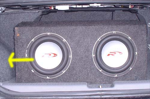

well .. seems that if you are going to build a box that wide, you may want to think about building an amp rack into it so that you can store your amp in there as well? just for ****s and giggles, here's the box I use in my trunk. it originally came outa my jeep wrangler, but fits well into the rear of the lancer trunk.
You may also want to think about maybe using the side walls and build a custom box into that to hold your sub? that would make it outa the way, allow for storage and still bizump.

Originally posted by digdat
[B]well .. seems that if you are going to build a box that wide, you may want to think about building an amp rack into it so that you can store your amp in there as well?
That's what I'll be doing. On each side of the sub, on the front panel, there will be a square hole, airtight of course, and each hole will have an amp.
Do you mean in front of the strut tower?
Actually, i meant in the trunk. I couldn't find a good pic of the trunk so I used my pic with an arrow :P
