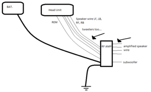

Sorry to bring up an old thread but I'm a little confused on this LC2i device (and maybe even how the wiring in my car is, I'm basing the attached diagram off all assumption and haven't actually looked at any of my wiring). Attached is a picture showing what I believe the wiring diagram looks like. Now my question is does the LC2i device tap into spot 1 or spot 2 (spot 1 being the left arrow and spot 2 being the right arrow for some reason the text there didn't save).
Attached Thumbnails How to add a second amp to lancer with the Fosgate system-amp-setup.png

is there no RCA imputs in the back of your radio? is it the NAV or just aregualr?
Old Nov 6, 2012 | 09:26 AM
johny 5's Avatar
Joined: Dec 2010
Posts: 25
From: AZ
It's the stock navigation system. No there is no RCA's in any part of the system.
