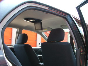

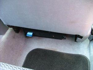

Finally got the digital camera, tell me what you guys think.
or
These pics are a little old now....that screen has been replaced......and here shortly the Dragon decal will be added to the car

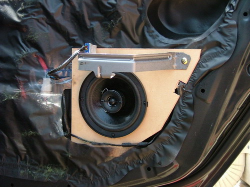

One more, a little bigger

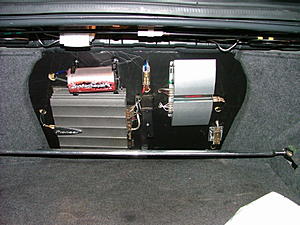

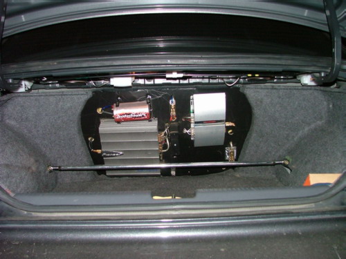

Missing pics of the trunk........someone e-mail'd me about this.
Attached Thumbnails Additional 6.5" Speakers-trunk.jpg   Additional 6.5" Speakers-trunk2.jpg
