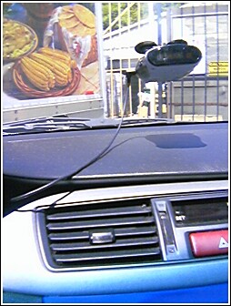

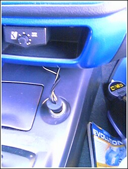

So this might not be audio and security, but it has to do with wiring. I have my radar detector on my dashboard, with the wire draping in front of my dash into the cig lighter. My question is this: Is there a way to route the wire behind or through the top of the dash (without drilling) and route the wire underneith to the cig lighter?

Mine doesn't plug into a fuse, it uses a cig lighter adapter. Is there a way to cut the plug off, put on the fuse adapter you speak of, and keep it safe? I ran the wire last night and it looks pretty good. The card wasn't long enough to tuck it completely under the edge of the dash, but most of it is there.

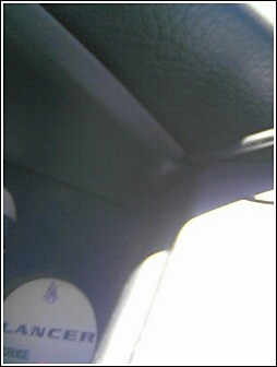

I hardwired mine from the circuit box up the left pillar, under the ceiling cover coming out just behing the rearview mirror, this way it hides the detector a bit.

Hook me up with pictures, I love pictures of custom work, and this is something I am really considering doing. It will free up my cig lighter, and look 10 times cleaner that the cord being stretched all the way around the dash and behind the glovebox.
Good idea, my roommate did the same thing, but kept his wired to the cig lighter. Unfortunately my window mount broke, so I have to keep it on the dash.
