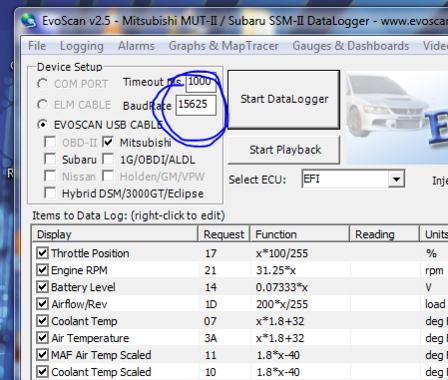

Which Ecuflash are you useing...? Becouse you need to be using ver. 1.29 for the lancers. The newer versions i've had trouble getting to work.
Originally Posted by ThunderOZ
Well that error is gone now. EvoScan opens up, runs, and clears codes. It just can't read codes or log for some reason... It say's it has a connection but nothing happens.
EcuFlash on the other hand works perfectly fine.
What you have set for your baudrate? Mines setting at 15625.
How do I check that?
It's one of the settings seen here in EvoScan:
