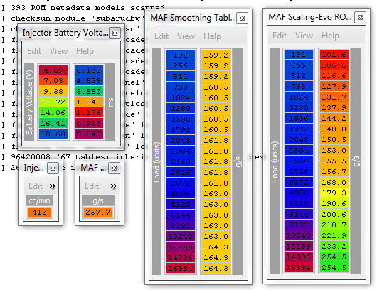

Here's my values from my 96420008 ROM with 440's and 501 MAF:

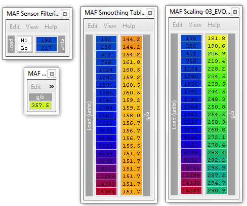

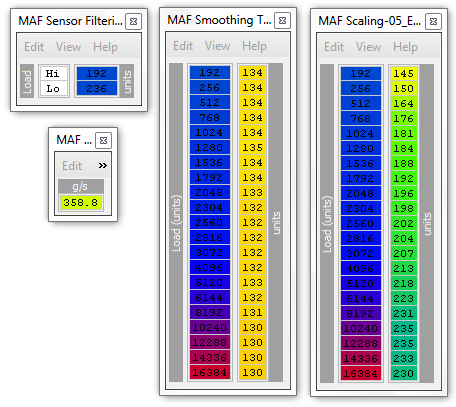

Those wanting to perform a 482 MAF swap on a non-turbo Lancer, you can use the values shown here, from a 2005 Eclipse GTS, as a starting point for your Lancer's ROM:
You can see that the values for the 482 MAF are sort of in between the values for the 2.4L 4-cylinder non-turbo 501 4G64 Eclipse MAF and the 2.0L 4-cylinder turbo'd 399 Evo MAF. To get this MAF to work on a non-turbo Lancer, proper datalogging and tuning will be required to adapt it to your individual engine setup.
Those with turbo'd Lancers performing this swap will see an easier transition as the HP rating and airflow of the engine the 482 MAF came from is pretty similar to that of a turbo'd Lancer.
If your Lancer is turbo'd and you are opting to swap to an Evo 399 MAF, you can use the values from a 2003 Evo, shown below, as a starting point for your Lancer's ROM:
Values shown above for the 482 MAF can also be used as a starting point for Lancers if the Evo's 399 MAF values gives your engine idling issues.
Same steps and changes in EcuFlash apply for this MAF swap.

Copy the values for a 501 MAF (or take my 501 MAF values that are more aggressive up top) and start from there. The 4G64 engine is like the 4G94 engine enough to let the values work right. From there you can adjust the MAF scaling to get your car dialed in higher in the powerband. Using the 399 MAF values directly isn't the best idea since they are made for the 4G63. You'll find your best tune with values extrapolated between the 501 and 399.

You're gonna want to tune the MAF scaling, but not in the lower Hz. I would also set the MAF size to the 257.7 of the 501 MAF and then move that value up once the tune is stable.

Set the sensor filtering at 501 MAF values.
