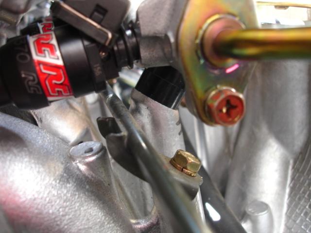

Hey guys, nobody knows the answer to this so hopefully you can help me.
I already installed the piggyback, wastegate spring, took off mas restrictor, etc, but all i have left is making the injectors sit in the fuel rail.
the instructions say to hold the fuel rail as far back as possible when tightening the 2 mounting bolts. i did that, but when i do there is about a 1/4in gap between the rail and the injector.
the idle isnt jumping and the vacuum is at a stable 18-19inches and if i spray brakleen on it, it doesnt jump.
anyways, my question is
1. are the injectors supposed to hiss pretty loud
2. is there supposed to be a gap
3. my idle is at like 1400 before turning it down, normal?
thanks for your help. ive read through the instructions like 20 times, but still cant get it.

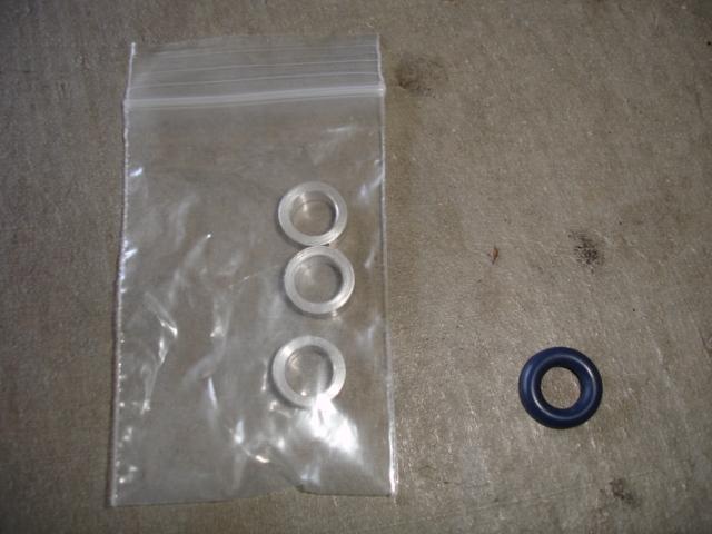

Heres a pic of what i mean. also, it came with these extra things and i have no idea what they are for. those 3 rings are metal and silver and the blue on is rubber.

the 3 rings are trash... they're for something different not applicable to your car. The injectors are not in the rail fully... you need to push them in all the way. Right now you have them out to far. The rail should go all the way to the shoulder of the injector just like the stocker ones do.
The higher rpms is due to the vacuum leak... even though the gauge is showing that there is good vacuum its a slight leak so the idle is excessively high.

put the injectors in all the way... set everything in place and put the bolts in. Then just tighten them down as it sits. That should work out. Take some pics that are a little further away and some from the top so i can get a better perspective of what's going on.
