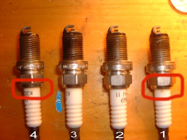

the four spark plugs with assigned cylindar numbers. notice #4 and #1 have yellow marks because i think they got too hot.
Attached Thumbnails another spark plug/engine problem-full4.jpg

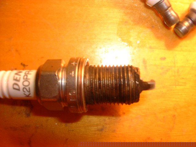

#3 when i took it out had wet gasoline on it. this is the plug i think was not working.
Attached Thumbnails another spark plug/engine problem-close3.jpg

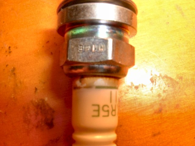

STOCK plug. notice the yellow burnt marks.
Attached Thumbnails another spark plug/engine problem-bkrbad.jpg

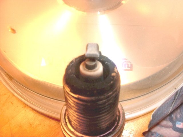

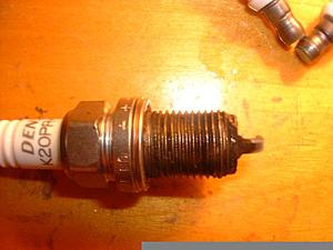

end of 1 heat range colder plug. is that burnt??
Attached Thumbnails another spark plug/engine problem-dirty1.jpg

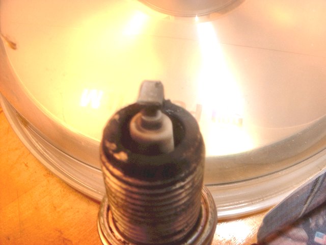

another shot of another plug
Attached Thumbnails another spark plug/engine problem-dirty2.jpg
Old Feb 5, 2003 | 05:22 PM
zlancer's Avatar
Joined: May 2002
Posts: 1,425
From: Jerzey
remember...this is only after 6,000 miles. i believe these can be considered burnt...the tips are grey and they jus look like ****. so do you think it was the plugs causing my bogging out of my motor? i replaced them with the same until i order the next colder heat range..and drove it around and it seemed ok. but i jus want some of your opinions.
