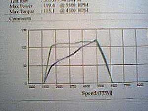

Said what the hell and dyno'd car today
imgsrc=https://www.evolutionm.net/registry/garage.php?section=dynos&action=manage&vid=3465&ms g=Dyno+successfully+added%21
I hope that works but 3rd gear on a mustang dyno pulled
119.4hp @5500 rpm
115.1tq @4500 rpm
The A/F ration was being monitored by a separate device and they said I was running 11:1 which is more suited to turbo cars. NA needs to be 13:1 or something like that. With an SAFC and proper tuning they say I am good for another 15-20whp.
I attempted a 4th gear pull but the guy quit at 55mph saying that the a/F ratio was 10.7:1 at that point and the car was stuttering.
For comparison purposes I watched the car before me , a 1999-2000 EX with a super charger and he pulled 150hp and 125 tq after their hour of tuning. So according to them I would be close to this guy after tuning if they can extract that extra 20hp. They had told him their dyno reads 15% low but never said anything to me.
SO here it is.
WADAD

doesn't seem too bad on a mustang dyno, though you def. need tuning (maybe something as simple as an FPR can help?)

holy mother punani. power curve was raised and smoothed. i like
numbers are great for a mustang dyno. figure 130 on a dynojet. get it tuned!!!

The torque band looks great... just need to trim that fuel out and you'd be up there.

YEs teh fuel curve will be killing your power and torque. Once you get that sorted out the car will be a killer. A good tune with an emanage or something equivelent nad play with some ignition timing will do wonders for you.
