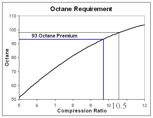

Originally Posted by HobieKopek
Here's a good link I found for you apes. j/p, always pickin' up new info so I figured I'd make up for my lost chart by sharing this.
http://www.daytona-sensors.com/tech_tuning.html
Interesting - according to the CR chart, the RRM piston crowd should need 98 octane to optimally run 10.5:1 pistons.
And yet Boe didn't blow up on 91...
And later on, we get this:
Originally Posted by the article
A useful rule of thumb is that raising the compression ratio one point (i.e. from 10:1 to 11:1) increases power by about 3%. However this potential power increase is only available if the gasoline octane allows running the engine at the MBT timing value without detonation.
Oh, that makes me annoyed.
Originally Posted by The Article
However, the practical limit for 93 octane pump gasoline is about 10.5:1. If you try to use a higher value, you will have to retard the spark timing to the point where the engine will actually generate less torque than one with a lower compression ratio.
I dunno where the 98 octane thing came from.
The % power increase is based on larger displacement motors I believe. The basic theory remains the same.

I went to 10.5; moved the mouse straight up; moved the mouse straight over; mouse was sitting in the high 90s. I estimated 98.
Here's an example...
Attached Thumbnails A/F ratio for n00bs-octane_requirement2.jpg

I didn't intend for that to be a guide for anyone's tuning uses.... it was more to help answer some questions that had been presented in the thread that it was plucked from. I, of course, don't have a problem with it being quoted, but at the same time, the caveat that it's not going to take into account all tuning variables needs to be presented.
FWIW "limp mode" has the AFR at 9.6:1
God I hate our ECUs....

Kris, that is understood. I just posted that so n00bs like me would have a basic idea what the hell was going on.

Oh, I see what you're saying. I was quoting from the text. I think that chart is ideal range, their comment mentions safe range.
EDIT: In the case of the Lancer I'm sure the ECU will just pull timing until it reaches whatever the max limitation of the ECU is. Then it'll throw a CEL and crap out into limp mode.

Ok, so here are my questions:
1) Is the graph accurate, because then at stock compression 9.5:1 we should be running 90 octane fuel, when recommends 87.
2) What does each pound of boost do to the compression ratio?
