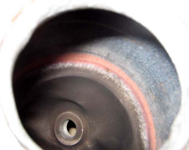

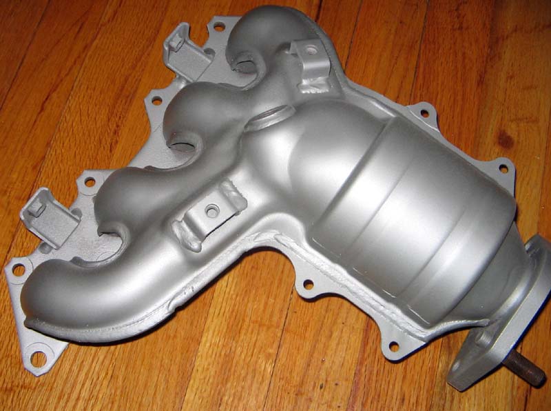

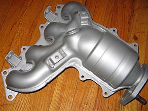

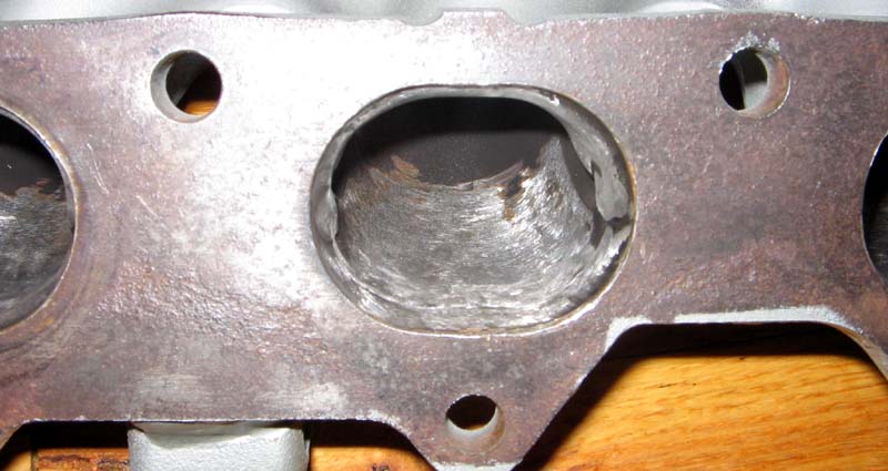

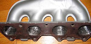

Final Stages
i did as alchemist said and picked up 120 grit paper and wet sanded the ports..boy did it make a difference. most of the surface feels as though it was never even grinded. it still looks a bit choppy but it feels incredibly smooth. i also got bored and painted the header with high temp engine enamel. the pictures came out a bit discolored since im using artificial lighting (due to the excessive rain this week). the silver really matches the valve cover pretty damn close.
header will be installed this week on either monday or tuesday. i will let you guys know how they feel once they are in the vehicle. keep the suggestions coming if you have any.
thank you again alchemist.

Old Oct 8, 2005 | 12:10 PM
Alchemist's Avatar
iTrader: (23)
Joined: Aug 2002
Posts: 2,204
From: Lynnwood, WA
Wow! Someone actualy listened to me.... awesome!
Looks good and I hope you get some decent gains from it
Old Oct 8, 2005 | 06:11 PM
N1te's Avatar
Posts: 1,704
From: Northern Virginia
haha didn't know that was such an anomaly and very nice work. looks 1000000x better too

i completed the install...let me tell you ---> those bad boys looked sweet until i started the car....the paint i used was Engine Enamel (high temp 500 deg) paint...it all burned off and smoked like crazy. i video taped it as i found humor in my work litteraly vanishing into thin air. if i find a way to upload it i'll post a link.
performance wise...it has been raining for a week straight here, forcasted to rain straight through this sunday. when i can crack open on dry roads i'll give a much better write up on them. they sound much quieter than the RRM header (which is good in a sleeper sense) there is a little more growl from the front of the car but there is no 'break up' in sound quality over 3.3k like the RRM header. there is no real comparison between the two though. the porting of the stock mani is pretty ghetto fab in a sense. RRM is just straight up pimp
