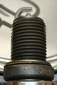

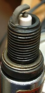

needless to say i was a little angry tonight. i had to make a drive before i pulled out the plugs. the car started misfiring terribly. much much worse than earlier. so i go home and let the car cool off a bit, pull the coils + wires off and find that again the same pack is arcing. the chambers did indeed have some dirt in them, but most unsettling amount of oil that was leaking into the chamber!!! oil was leaking through 3 of the 4 gaskets on the chambers. when i removed to plugs i found that they were pretty clean and in decent shape still.....that was until cylinder 4. this is the cylinder where the arcing was taking place (as usual). i took several pictures for greg. the plugs where autolite platniums from a week before x-mas (about 1200 miles on them). all 4 plugs where BURNT at the base of the porclein (not a residue...burnt!!!!) so yeah. here are some pics. more will follow in the next post.

now here are the interesting parts. cylinder 4 plug was CRACKED enough to put a flat head screw driver in it. the boot on that plug was pretty burnt as well.
i replaced the boot with a spare i had laying around, removed the valve cover and sealed the spark gaskets with RTV silicone, and replaced the plugs. i got a set of NGK V-Power plugs. the guy said they are one step colder. i think they were $2.13 a plug or something like that. the car is running much smoother. no more misfire. no oil in there anymore either. i'm hoping this is the last time i deal with this. my 6th misfire problem since July 2005.
