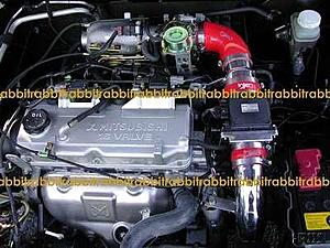

Do you have any pics? I would like to see where they locate the filter etc.

Here is a pic of the intake... this isnt MY lancer but it looks exactly the same. Also, if you get and are going to install this intake, one the the steps tells you to remove the whole front bumper to cut a hole for the pipe in the splashguard... if you go underneath the area where the filter will sit you can pop out a few plastic clips and take the piece that need to be cut off so its easier to cut... its ALOT faster and easier this way.
