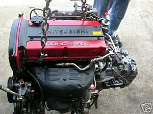

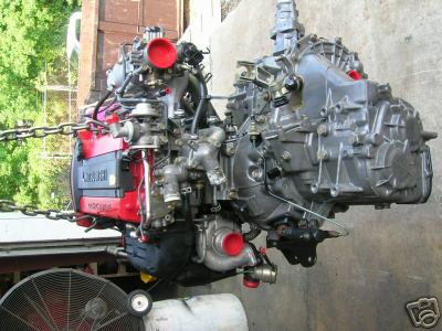

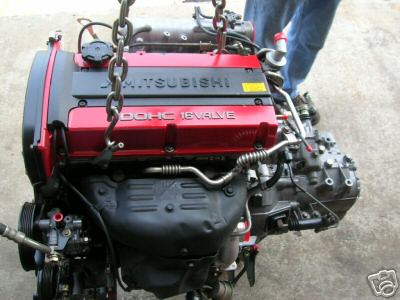

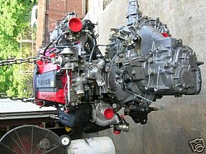

I just want to post some pic so people can determine the difficultly factor for themselves. These are pics from a 4g63t EVO 8 Motor. Can someone post clear pics of an 02-03 or 04-06 Lancer Engine in and/or out the car in this thread please.
Attached Thumbnails The 4G63 into a Lancer mega merge thread-96_1.jpg   The 4G63 into a Lancer mega merge thread-04_1.jpg   The 4G63 into a Lancer mega merge thread-54_1.jpg   The 4G63 into a Lancer mega merge thread-62_1.jpg

^^Okay notice how the timing belt cover is on the left in those pictures^^^
Here is a pic of the 4G63T in my Eclipse:
