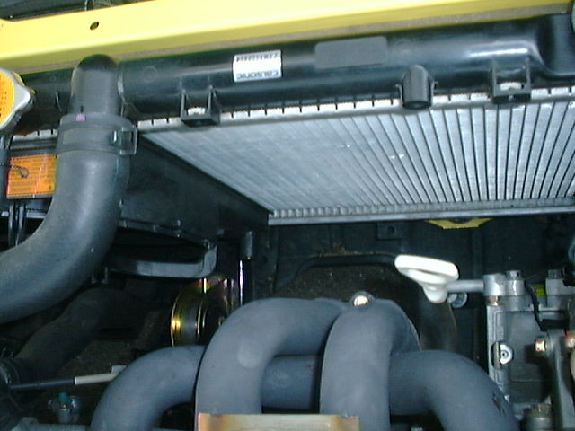

In the interest of gaining much need space behind the radiator for another project I slapped this fan on the outside today, like the Modern Image car.

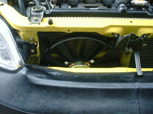

Here it is on the car. Had to do some bending on the metal to get it to spin freely.

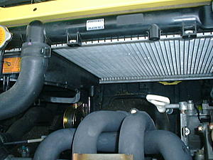

And look at all the space you have behind the radiator, a perfect place for your cat to sleep or maybe some extra manifold piping .

Oops forgot pic

How much "bending" did you need to do to get it to fit and spin freely?
Old Jun 30, 2003 | 06:10 AM
airlinevomitbag's Avatar
Joined: Aug 2002
Posts: 995
From: Otsego Minnesota
All you have to do is pull the AC radiator thing back and hit the sheet metal that surrounds the opening you only need to gain 1/4"-3/8" and it is hardly noticeable, or just go with a 10" instead of a 12"
