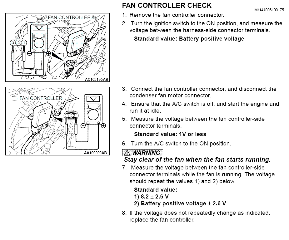

hmm im overheating too. well it hasnt like made the car stall out or anything, but my fans wont turn on so i know thats why. but i know ive got it all wired up right, so i think my controller has gone bad :/.
but anyway my stock water temp gauge gets to a little less than in the middle.
what should be the spot where i should really worry, and whats yours at right now when you say its over heating?
These may be of assistance for anyone wishing to verify the integrity of their fan controller.
Attached Thumbnails My car is overheating..-fan_check_1.gif   My car is overheating..-fan_check_2.gif

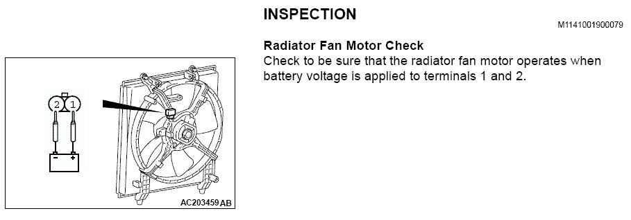

And here is for the radiator fan and secondary (A/C) fan.
Attached Thumbnails My car is overheating..-rad_fan_check.gif   My car is overheating..-ac_fan_check.gif
