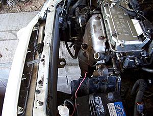

almost ready to begin the lift

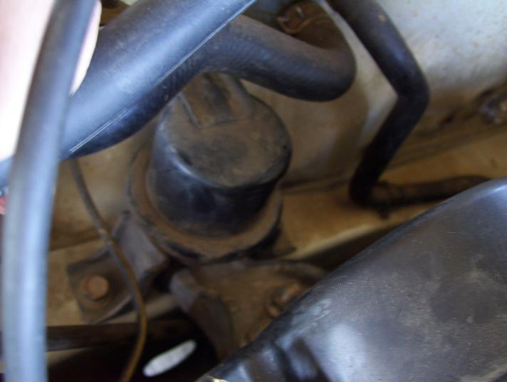

the only motor mount which actually attaches to the motor?

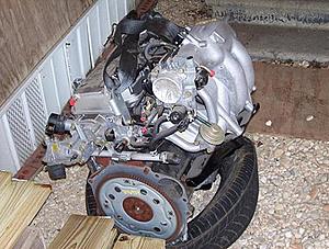

the new engine.

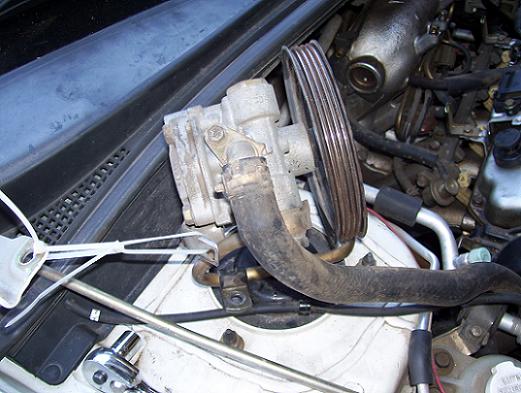

this is where i moved my power steering pump for the removal

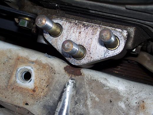

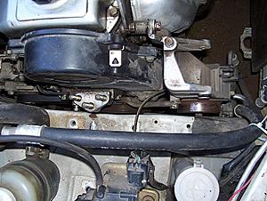

this is attempting the lift. this is the motor mount, right below it the crank pulley, etc. NO space whatsoever and i still need another 1/2" or more to clear the bellhousing.

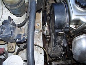

this is the view of the flywheel/bellhousing from the same moment as the last picture in the previous post. see, no clearance.
as you can see, the tensioner is hitting (among other things)
i took off the tensioner AND the housing to which it was attatched. still no clearance.

any suggestions? will i have to remove my crank pully/alternator? what about putting a jack beneath my transmission, undoing the mounts on the tranny, and cocking the bellhousing up a little. would that work?

If you need more room you could undo the two trans mounts and try to angle it a little. It should clear without removing the trans. You will need to angle the engine so the belt end goes up first.
