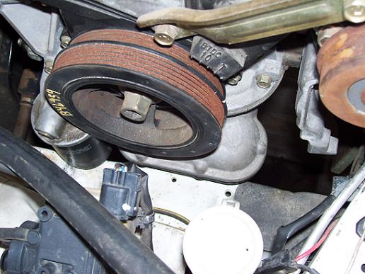

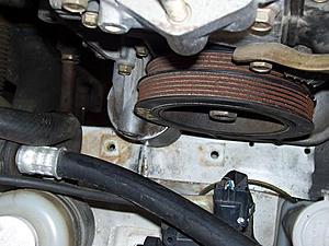

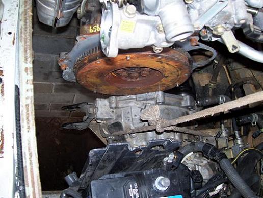

so now that i'm in the process of putting the new engine in, i am again running into problems...
is there any certain way to twist, turn, augment, or any other thing that will give clearance... something that's simple? am i overlooking something?

Take the oil filter and crank pulley off and see if that gives you enough room. I seriously have NO idea why you don't have enough room. Like you said, it must be the accident damage.
Since everything else is apart, you might as well just lower the trans out of the way instead of fighting with it. It's only another couple of minutes to do.

and mcgarvey... i finally took your advice and unbolted the last tranny mount and pushed the whole thing towards the driver's side.. i didn't undo the driveshaft, but it still gave me JUST enough clearance to fit the flywheel into the bellhousing. from there, i was able to attach the clutch assembly.
the rest should be fairly easy. thank you guys again!
