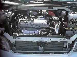

i have done it
i put the injen intake on a auto lancer and it works great just had to bend it a little bit the black part of the auto trans was in the way .but just a little and the power gains are the same.

can you post some pics?
hey bro, can you post some pics of the injen intake installed in your automatic, but i saw your one pic, but can you take a few other shots. Some taken looking down on the ingine. thanks
