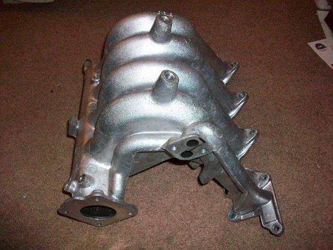

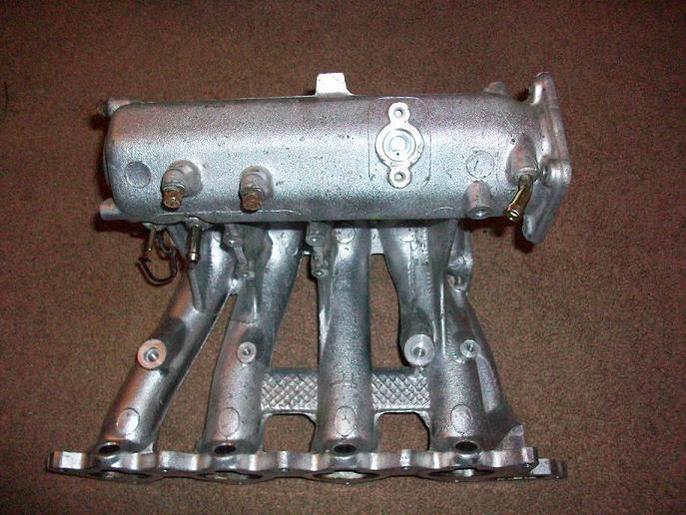

Get a 4G92 mivec one.
Here i got comparison between 4G93 and 4G92 manifolds
4G92 vs 4G93
4G92 vs 4G93
4G92
4G93
4G92 manifold a lot bigger plenum 60mm flange with massive runners compared to 4G93. Worthy mod and cheap so PM me haha

What do the runner's look like side by side? And do you happen to have a flow sheet on the 4g92 vs 4g93 or 4g94?
hmm i can take more pics later if you like when i find some time. flow sheet that i definately dont have to be honest all i know is its a lot bigger than the 4G94 or 4G93. Both plenum and runner size, in that note im not saying bigger flows better but i thought i would brong it up ehh cause it is quite large

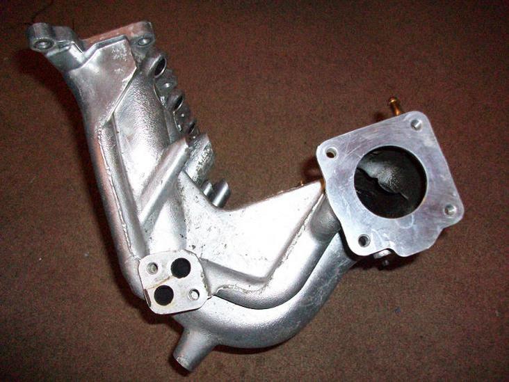

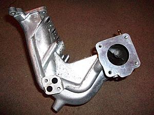

So im pretty sure the junk yard gave me the wrong intake and cam. They said the engine was a 1.8 but the manifold has the runner's look like the 4g93 pictured above but were the tb mounts look's like the 4g94 so is this a 1.5l intake?

Take a picture and show us, if it's a 1.5L I believe the differences are pretty much noticeable that you wouldn't need to ask. I'm not sure though. Pictures speak louder then you! Give us a picture

If its a 1.5 there should be a temp sensor and map sensor hole, take pics

So does not look like the 4g93 intake above but it also does not look like a 4g94 intake? What is it?

4g15 sohc manifold
