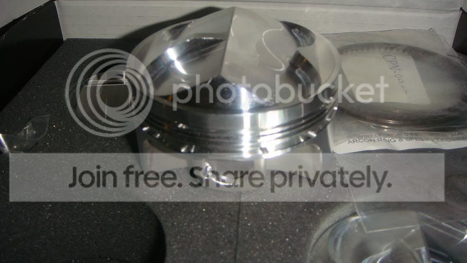

pistons
made by CP to suit mivec 4g92 head and 4g94 block, head was physically sent to CP to 100% match the cumbustion chamber.
Our very owned forge h-beam rods for the 4G94, comes with ARP 2000 series rod bolts 100% weight balanced to the nearest gram
I also have a brand new 4G94 crankshaft

will those pistons work with the non mivec head as well? Is their any work done to the crank like lightened or anything?

They should however you have an option to run a 4G93 Mirage 5g high compression pistons from Wiseco or something. It will be a lot cheaper, the 4G93 pistons will suit the SOHC and DOHC non mivec combustion chamber.
Crank is stock but balanced along with flywheel, brandnew crank pulley and clutch plate.
