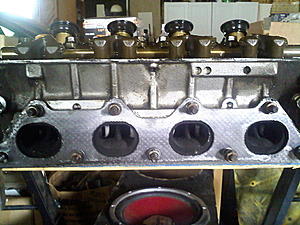

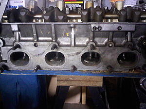

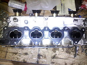

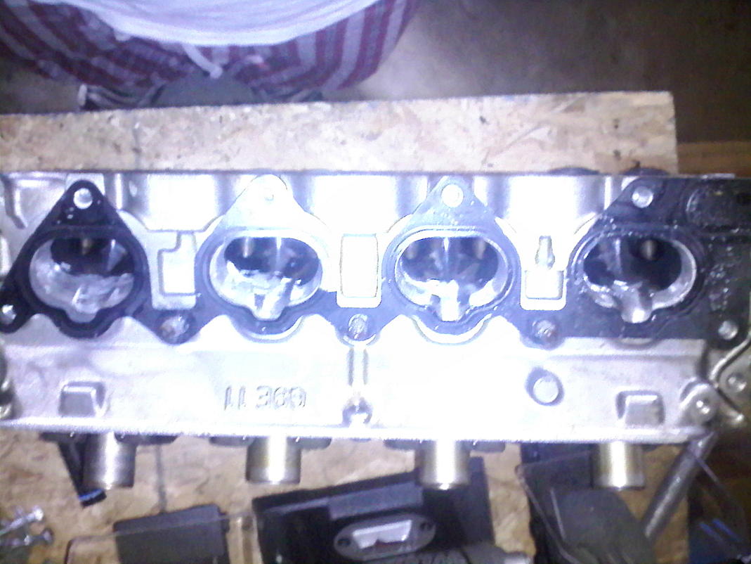

imalancerman's Avatar
Posts: 623
From: Creswell, OR
Pics of my head port match
Here is what Im talking about, sorry the pics arent a little better. You should only have to remove a small amount of metal from the intake side which I finished up with 120 grit and quite a bit on the exhaust side as you can see in the pics which I finished up with some fine grit emery cloth. Turned out well I thought. If you want a write up on how to do it, look for the thread on porting your own intake manifold and follow their instructions just dont go too far in.
