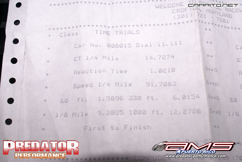

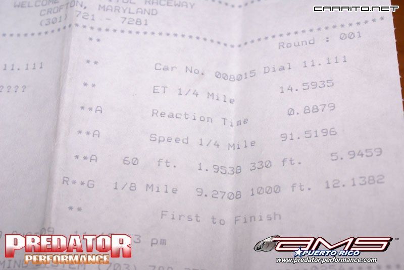

Today we went back to the track looking for some better numbers! After spending a few hour on the dyno playing with the Mivec we now have a better torque curve with more area under the curve, the final numbers were 164whp and 163trq, definitely we are almost at the limit of the stock engine, to go higher we might need to do some head work or camshafts on the car, the stock engine its approaching its limit.
We arrived to the track and did the first pass without letting the car cool off or anything, this were the results:

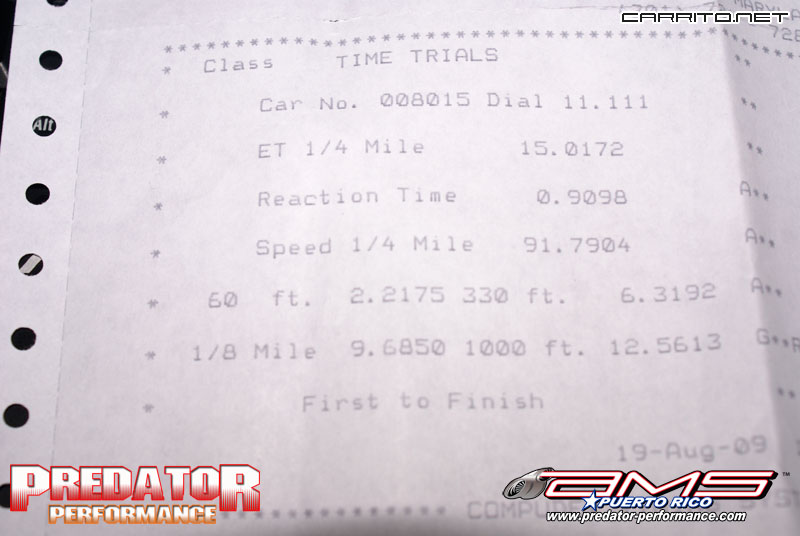

After that we knew we could do 14 second passes in full street trim. Then we did some changes to get better 60 ft.
This are the only 2 passes we could make tonight:
We are very happy with the results, not bad for a stock engine with a few boltons. From now on the road to more horsepower is a lot more difficult! We will keep you guys informed! We definetely want more horsepower!

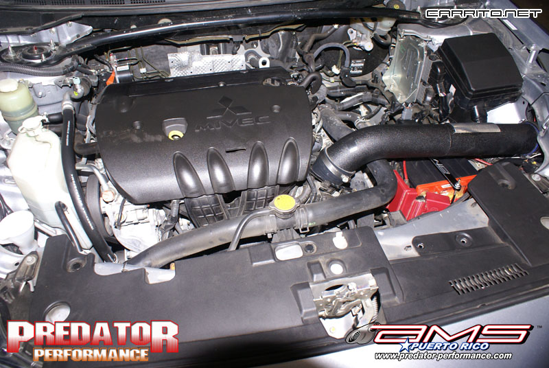

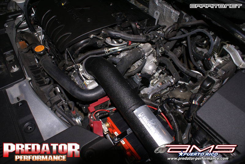

A reflashed Lancer is a different story. Check out the custom intake we did, its the shortest intake possible using a mini battery kit, that thing sounds sick! But we are not using it because we really dont need it right now, it will be used in the future, for now the RallyArt scoop and EVO X radiator cover(has bigger holes for air to go thru it) are more than adequate to get some cold air on the engine, and the car is not that loud :
As you can see we are doing a lot of experimenting with the car.
