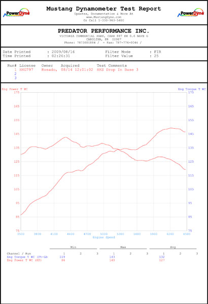

This were the stock numbers on a Mustang Dyno:

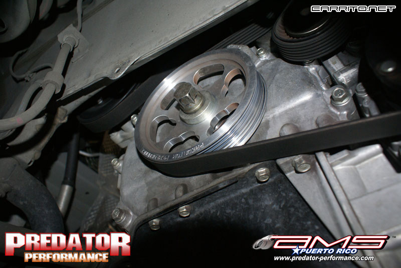

After that we installed our own Predator Performance Pulley:
The only other mod the car has is a dropin HKS filter and the intake scoop from a RallyArt Turbo:

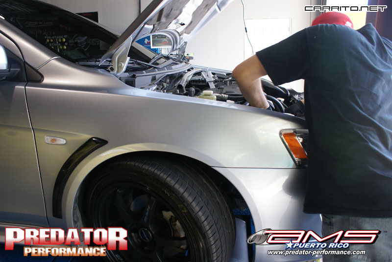

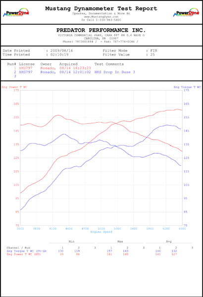

Then, we performed a basic Predator Performance reflash in our dyno and these were the results:

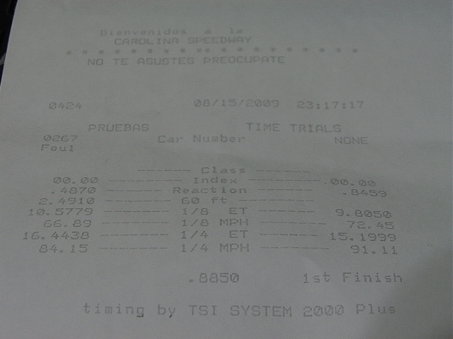

Not bad considering the basic mods the car has. The next day we went to the track and this were the results:
60': 2.2
1/8: 9.80 @ 72mph
1/4: 15.19 @ 91.11

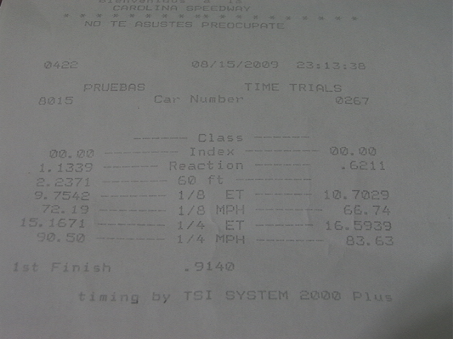

60': 2.23
1/8: 9.75 @ 72mph
1/4: 15.16 @ 90.5
Those are just 2 of the 5 passes we did, all of them between 15.1 to 15.3 and always 90 to 91mph. We think those are good gains for such minimal mods and a very quiet car.

We spent a little more time on the dyno today trying to get more horses, we saw some gains playing with the Mivec, the car now has 165whp and the torque curve looks a lot better. This is in a Mustang Dyno that reads around 8-10% lower than a Dynojet. The car still has no intake or exhaust, just axle back.
We will continue with the tuning, but we are now seeing that the cat is becoming a restriction when its cold, apparently when it gets hotter if becomes a lot more efficient. You can clearly see it in the curve and AFR when you do 2 pulls in a row.
