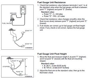

My gas gauge is off and im looking to get a fuel glowgauge like this http://www.glowshiftdirect.com/elite...vel-gauge.aspx
However, I dont know my ohm sender level. Could someone please help me. I have a 2002 Mitsubishi Lancer OZ RAlly. Does anyone know the Ohm levels?

Here's the info from the FSM:

Thank you man, so those are the standard ohm values for a 2002 lancer oz?

Yes.
