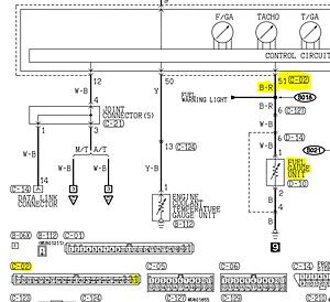

I am trying to install a fuel level glow gauge in my car and I can't seem to find a diagram online to figure out which color the fuel sender wire is on the console so I can splice it and connect it to my new gauge. Can anyone help me!

It's a black w/ red stripe wire that is in the last pin of one of the harnesses in back of the cluster. See the attached diagram:

could you help me with one moer thing. So, I called the company and I need to wire the fuel gauge before the ecu because the ecu is messing up the ohms. So, I am trying to figure out which wire I need to splice at the fuel sender in the back of the car. Could you help me with another diagram? Thanks

Same diagram, dude. The white w/ black stripe wire coming from the fuel gauge unit.
